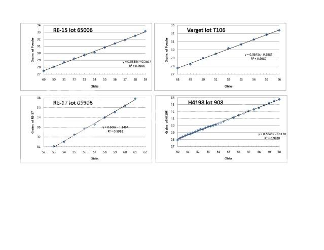

I build calibration plots by running my 4 most commons powders all the way though the range a BR case would use. I did them at every 0.25 clicks to start, then 0.5 clicks, only each full click on the remaining powders for the whole range. Very linear. I usually do load development at home with a my Chargemaster, but found it difficult to use in windy environments (every BR match I have been to). Here is what my plots look like. I have them taped into each log book and the lid of my range box. I find they value to get close with having to mess with a balance at the range. All weights were measured with my Ohaus (0.001 gram readability).
