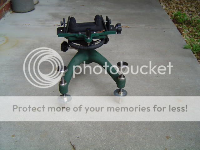

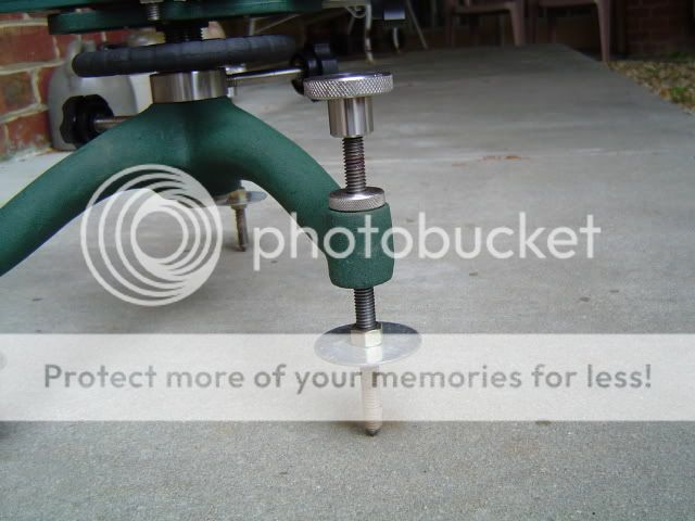

Yeah, works great. I alternate between the extended screws/fee and the factory screws/superfeet depending on whether I shoot off the ground or a bench, respectively.
Only center post of the Caldwell is different from other rests (and in fact differs between the same Caldwell rest depending on vintage; they recently changed it according to Butch Lambert).

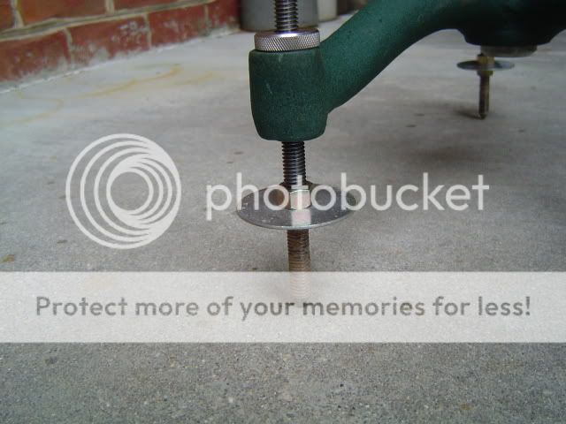

Go to the hardware store and get 3 Fender Washers and 6 nuts.
You can adjust how much penetration you want depending on soil conditions.
I have mine set at just under 2", which is NRA legal for F-Class.
Once you get the feet set and leveled it stays put.
