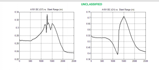

South Pender, don't look to gyroscopic stability. The shape of the bullet base is the culprit.
When the bullet speed drops below Mach 0.9, the flow of air around the bullet base changes. This causes what you describe.
It is known that sharp corners in the base area may reduce this effect (balle D), rounded corners increase it (typical 7.62 NATO). Straight bases are less affected than boattails, which of course is bad news for long range shooting.
It takes a multimillion dollar radar to follow rifle bullets beyond the point where velocity has dropped below Mach 0.9. Therefore, the only way for you is to test and compare several bullet candidates on the range.
If you look for more information: search for "Magnus moment" (do not confuse with Magnus effect).
Great responses, guys. Thanks for this information. If I'm reading this right, it looks as if the effect at long range is primarily on the BC, rather than stability.
