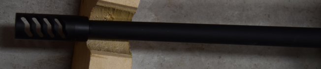

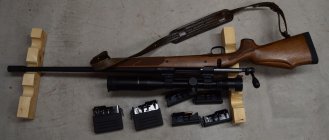

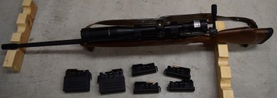

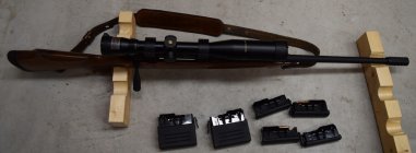

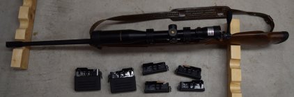

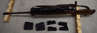

I build a custom Savage 111 for my wife (based on a 111 LadyHunter), 5R Krieger barrel (6.5x55), 20", 1:8. 85gr did not shoot good int. anything 120gr to 160gr that we actually 'developed' did produce 1/2MOA eventually. So, its a matter of what you can find. 140gr Berger Hybrids is something to try :) too.
here it is
