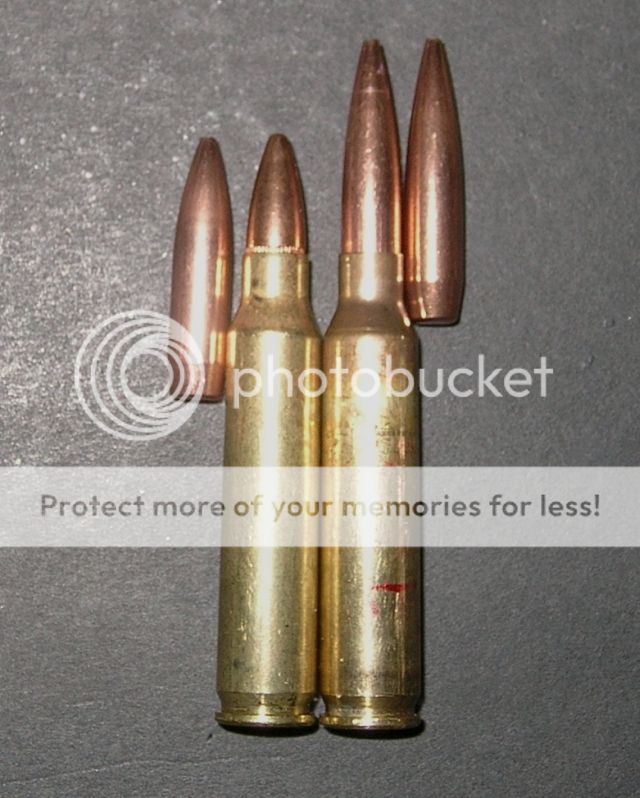

Listen to what 308Warbird is saying. The 80SMK is not intended for, nor can you safely load it at, mag length. I suggest you stick one of the 80's in a fired case at mag length, and then you will see exactly why you cannot do it. Virtually none of the bearing surface of the bullet will be in the neck of the case. It will be close to dropping right thru the neck, with no tension at all. The 80 has a different shape, higher BC for the 600 yard line. The 77's ogive is a lot further forward, to get the bearing surface needed for mag length loading. You also have to have a chamber that is properly throated to utilize the 80's at common loaded lengths. (seated well out, to get powder capacity) For the avg. AR shooter there's not much difference between the 77 at mag length and 80's loaded long. A lot of top high power shooters/teams use the 77's all the way out to 600.

No arguments here at all and I did mention in about my 3rd post or so that I could just manually load the rounds into the chamber to shoot them. The Jack Carbine is a 5.56 Nato so I guess some of those are not able to accept the longer rounds either(chamber, not mag). I do and have have loaded the 77gr Sierra bullets and they shot OK but I seen the 80gr at the LGS and thought they might be better..thought ;D
Anyway like I said earlier, I'll put those 80gr into the vault or sell them. Just FYI though, here's a pic of the 77gr & 88gr bullets next to dummy rounds I made up with the right one being the 80gr bullet with an OAL of 2.550 and the left of course is the 77gr wc bullet in a OAL 2.255 round.
