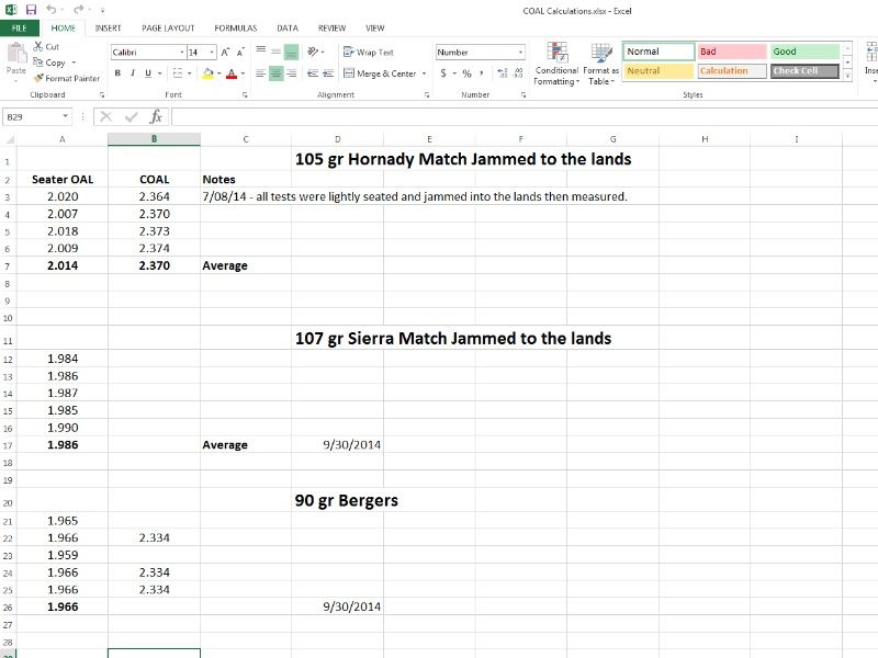

Hello -- Am new to metallic reloading and was wondering if someone on this forum could point me to some sample charts or tables of bullet seating depths. I understand you have to develop your own data for different bullets and rifles. Am looking for ideas on how to organize. Thanks

I'm not sure you are going to find what you are after here. There's not really a "formula" to it, that lends itself to an Excel table or something. Really it's just a matter of picking a starting point (say, +.000" which might represent your OAL reading from whatever tool or method you are using) and then subsequently subtracting whatever amount you want to test by. -.003" , or -.005", or whatever. My test setup (in a spreadsheet btw), just looks like:
Test: Result: Notes:
3 x .000" <some_result_here> <some_notes_here>
3 x -.003" <some_result_here> ....
3 x -.006" ....
3 x -.009"
3 x -.012"
and so on. I guess you could write a formula to iterate that to whatever end you want (.030" maybe) or create a formal table layout, but that's probably more effort than it's worth.

Here is an Excel spreadsheet for my 6BR where I recorded the length of various bullets from the base to where the seater of my Forster micrometer seating die made contact with the ogive. The bullets were lightly seated long in a dummy round and carefully jammed into the lands. Use only one bullet for each weight and do it several times and take an average. Using this as a starting point you can tune your depth for the best accuracy. As everyone else has alluded to seating depth is like finger prints. Every single barrel is different.
