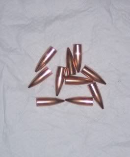

Sometime back I'd decided to see if I could make good .30 cal. bullets. To make a long story short, I rounded up all the gear needed, pestered Randy Robinett mercilessly :eek: for info and am finally set up to make some. I've spent the last few weeks getting the hang of core cutting, core squirting, core seating, lubes and trying to learn what sorts of changes happen when you make little tweaks on the die adjustments as well as different techniques for the different operations. I'm still pretty clueless about a lot of it..but not quite as clueless as I was a while back. So..here's my first ten 118's that came out this evening...seemed somehow fitting on Easter Sunday. They measure good and as soon as the weather straightens out, I'll see if they shoot.
Hope I pointed the right end. :D -Al

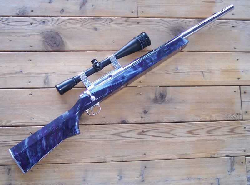

Here's my best effort to date, fired yesterday. Also fired a .106 and a .116 as I messed with the seating depth a bit. Shot some 12 shot groups a week or so back..they went .235,.263 and .216. My rig is pretty standard fare with the exception that it's a 10.5lb rather than a 13.5lb gun like most 30BR's: Kostyshyn 1:17 four groove, Sightron 36X, chambered by Stan Ware and pillar bedded and stocked by me in a Bruno/McMillan pattern stock.
