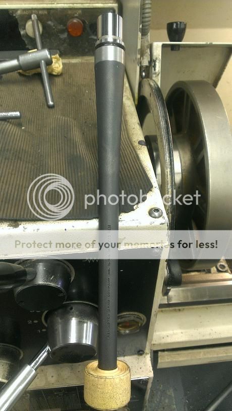

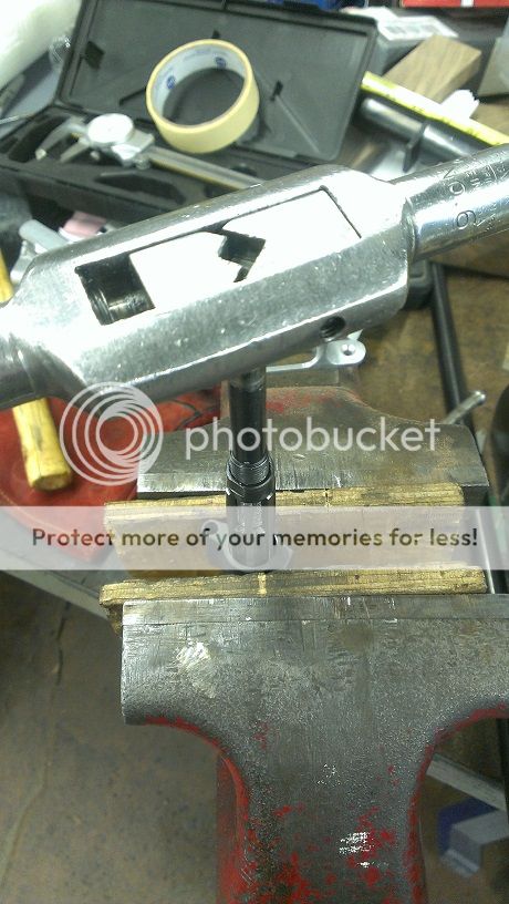

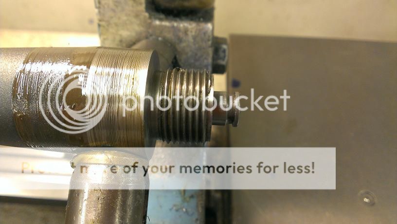

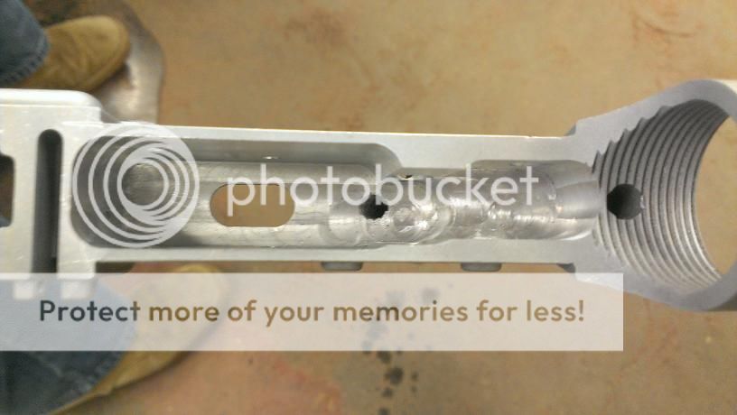

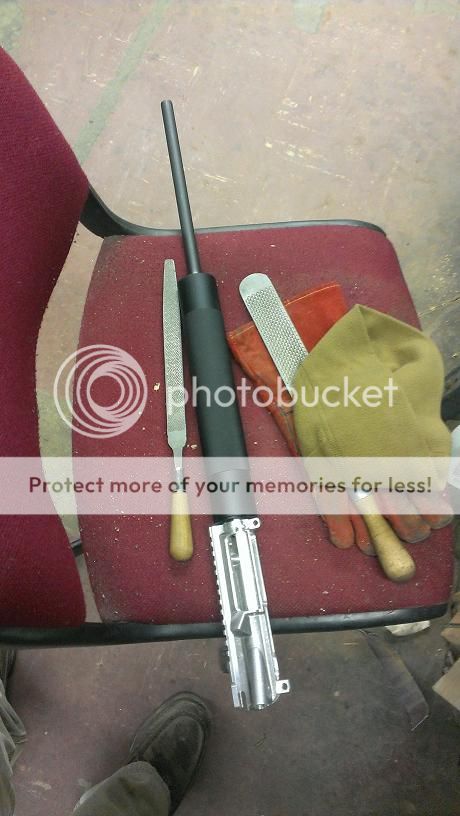

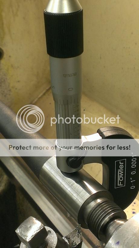

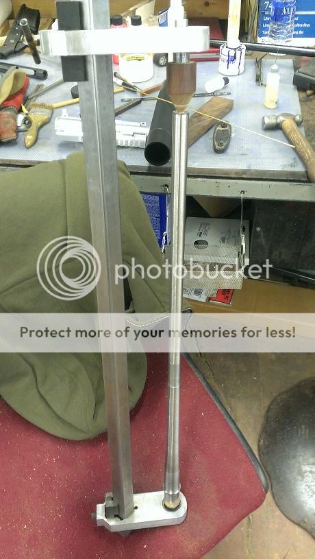

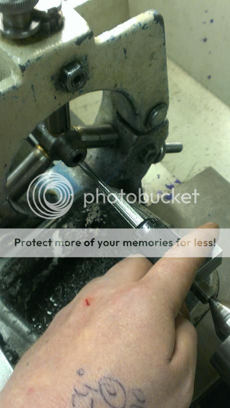

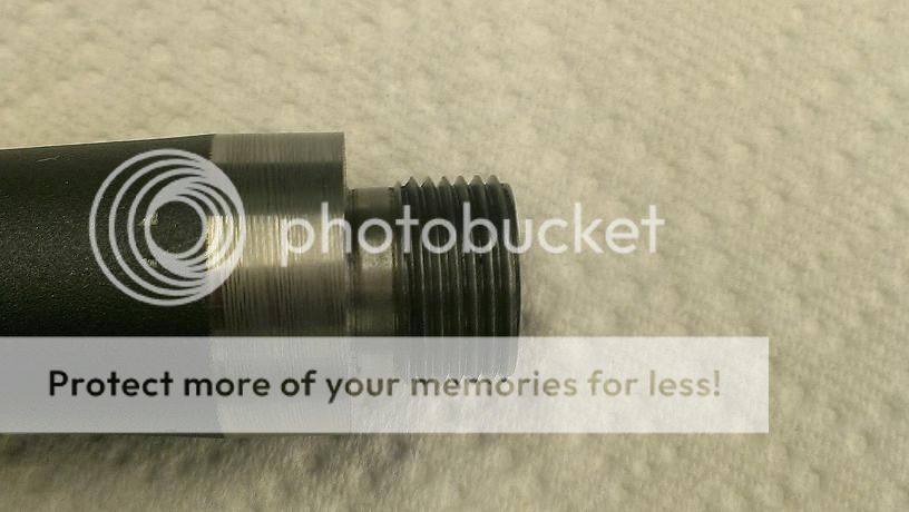

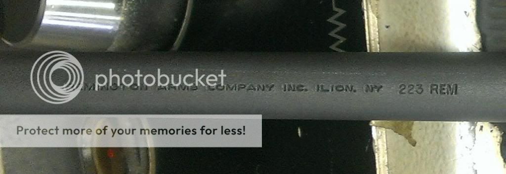

I have not built an AR prior to this. For the pure learning it provides I decided to build one. I started with a very inexpensive 80% lower and milled it out. Afterward I decided it needed to be hot pink, IO can't stress enough the color it came out to be wasn't what was pictured, laser pink is the most neon color I have seen. Next I had a 223 Remington 700 take off barrel sitting under my bench, so I face it off and found that when you remove the bolt recess you only have to re-chamber roughly .075" to be right a spec. which is very nice. I cut 60's on both ends and turned the shank down. From there I threaded the shank. I set up in the steady rest and headspaced and finish chambered the barrel. I then cut a 29* cone in the breech .570" wide to facilitate feeding. Then I flipped it over and crowned the barrel. I also had to turn the shank down to 1" for the lock ring to slip over the barrel. The last picture is of me opening the gas block from .625" to .700" so I didn't have to contour the sporter barrel, just the seat for the block. This week I will cut the seat and install a rifle length (12") gas tube. I am still waiting on a few parts so I might not be able to finish it this week. Thus far I believe I have $275 into the whole project. It has been fun and all I can say is those people who think slapping an upper on a lower or torqueing a barrel to an upper is gunsmithing, you're wrong. Anyway I'll keep posting pictures,

Well finished it up today, well as much as machining goes. I had to turn the gas seat (PITA) and then I torqued the extension on. I set it up in V Blocks and leveled it, used a pin to find top dead center and then moved down until I hit the mark I transfered to drill the port. I used a center drill to peck the starting hole. Then I started with the .060" drill bit and moved up to .073", bur free and right centered on the land and groove. After that I used the barrel spinner and cleaned up the barrel.

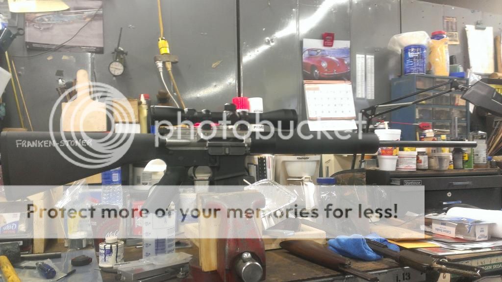

Well I shot the upper today. I was pleasantly surprised, it cycled soft and smooth with no hiccups. The brass ejected fine and didn't hit the deflector. This was with a CAR buffer, tube, and spring. I didn't have optics on it so I don't know the accuracy of the barrel.
I also left the barrel @ 23".

I had to abandon the pink one for now, put too much paint on it on critical areas. But I present the Franken-Stoner.

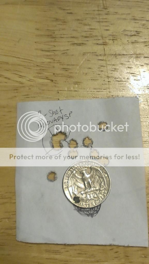

Well it shoots, pretty well too. The three shot group (circled) is from factory Hornady SP bullets and the rest is a mixture of blasting ammo my dad loaded. I think it's a keeper.
