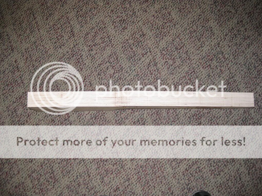

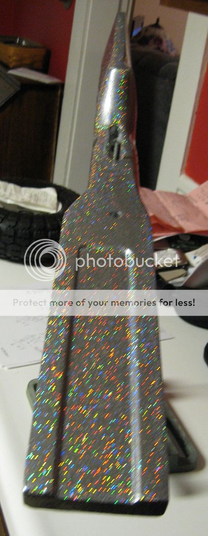

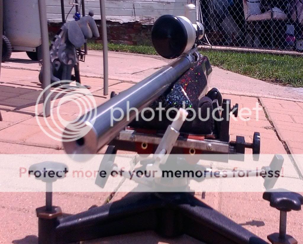

Heck I built my own BR stock out of a 4x8 sheet of plywood, I bought from Menards. The guns shoots well, and tracks prefect. I won a couple of match's with it, and some money. I wanted a "Dog Tracker" style stock so I off set the forearm. Works well with the fast twist barrels used in 600 and 1000 yard Benchrest. The only problem is this that is so light, I have one heck of a time getting it to weight. I made a thick butt plate to help. The stock cost me $18 bucks in materials.
A couple of pictures without pain when it was in primer, and I shot a couple of match's like that.

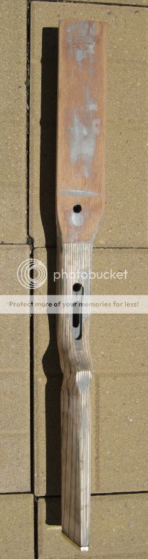

Couple of pictures when I was building it.

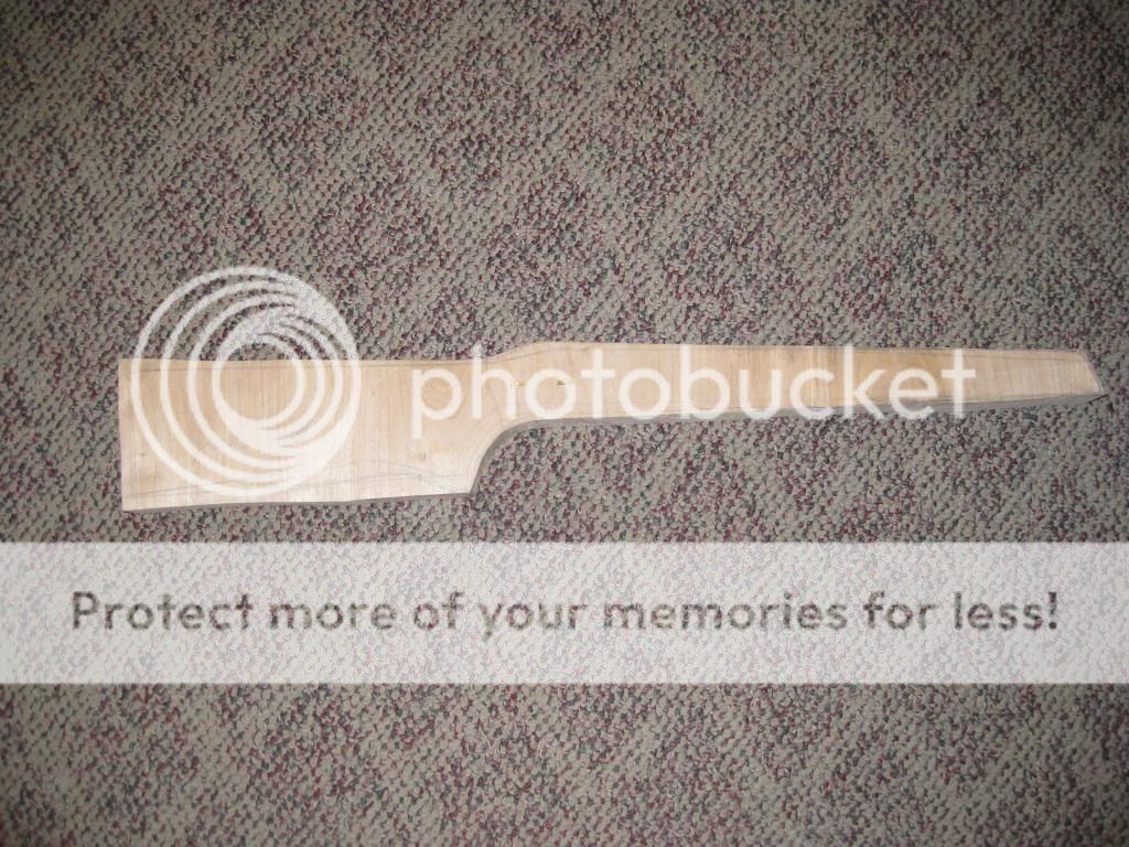

And how it started out, when I laid out the laminates.
82 boy Great job. I like the alpha Jewel [ metalflake ] paint.

Well unfortunately I never weighed it. I opened up a few spots in the stock, (Up in the forearm, and where a magazine box would be.) where I epoxied six 1 lbs. incants of lead. In the back I drilled a 1 inch hole about 12 inches deep, where I have filled with #7 1/2 lead shot. The brass butt plat is 1/4 inch thick. with that all said with a Savage action, weaver T36 scope, and a 28 inch long Shilen #7 contour barrel, the gun weighs in at just barely 16 lbs. (15 lbs 10oz to be exact.) I do have a second blank that came from this same board and I could weigh it. It would have a lot of material more than the final stock that would skew the final results. It might average out close as the blanks forearm is only 2 inch wide, where the finished stock I laminated up extra material on the forearm, to make it 3 inch wide.
The wood I used was 1/8 lauan plywood. I would say it is fairly close in weight to a fiberglass stock, like a McMillian Edge, or TMBR.

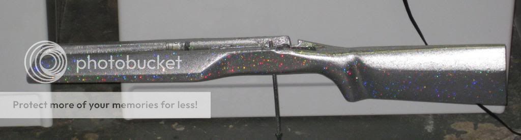

Well, The photos are not total correct. I did not like the silver after I shot it so I striped it down and repainted it black. I like this a lot better. You can also see how I finished off the brass butt plate.
Before.
After
after
