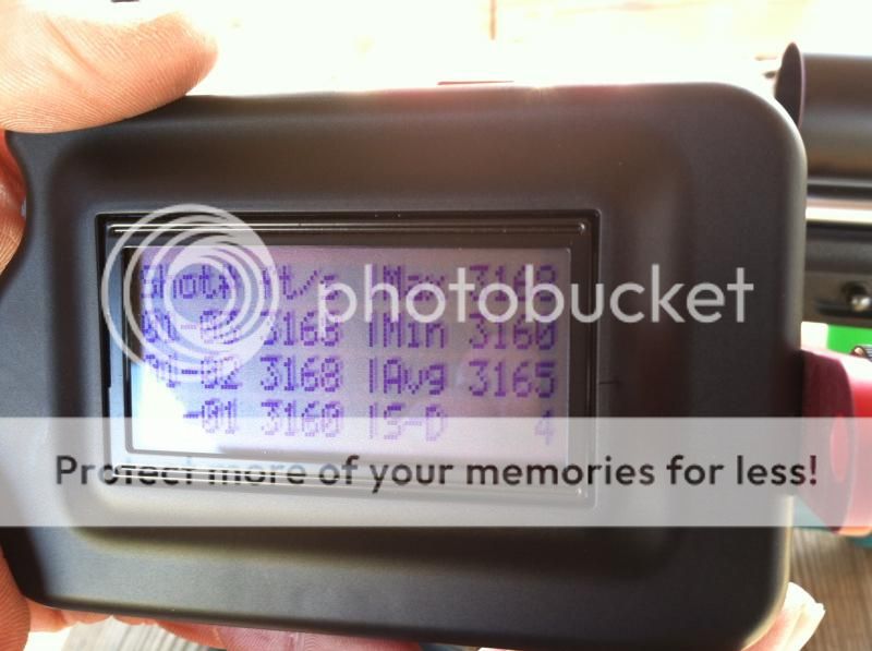

As it's turned out the 6XC hasn't been much trouble either.....With 105 Amax bullets and stiff doses of H4350 or RL17 my velocities have been quite good from the 28" barrel. I won't post my charge weights (PM me if you'd like to know) but I can tell you the speeds and standard deviations.....they are zinging out of the barrel at 3150 with RL17 to 3165 with H4350 FPS (measured at the muzzle with a magnetospeed) with H4350 having an SD of around 4 fps and RL17 around 8 fps.....I was shocked....here's the chrono data which has been very consistent shot to shot once the barrel is warmed up:
I'm using Norma brass, the aforementioned powders, CCI BR-2 primers and 105 Amax's seated about 10 thousandths off the lands. All put together with a Forster BR FL sizer and micrometer seater.

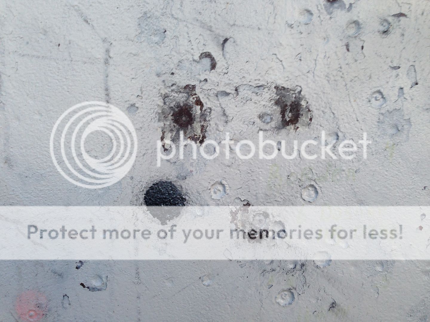

#3.....and last but certainly not least how well it is shooting at longer ranges?......800 yards is all I've tried thus far but I was very surprised at the results....Like I said it hasn't been a great 100 yard shooter but it's turned in groups like this @ 800 yards on a couple different occasions so I see no reason to believe that it'll perform any differently in the future.......
That's a 1 inch dot......I know it's only 3 shots but there are reactive targets to shoot at too and it's much more fun to shoot those than it is to shoot groups....
