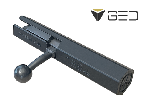

I bought this, it unloads the firing pin spring and protects the bolt whenever it it out of the rifle. It de-cocks the bolt when you insert it and re-cocks the bolt when you remove it. I use it when 1) transporting my rifle, 2) when in competition you have to remove the bolt to prove the firearm is safe and 3) when I store the rifle in the safe.
FYI you can just ease the bolt down as you simultaneously pull the trigger and the bolt will decock without damage. Works with most bolt action rifles.
