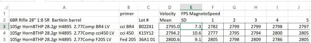

I ran and attach results from a small test with 6BR target cartridges comparing CCI BR4 primers to CCI 450 and Federal 205 primers. Velocities were measured with a MagnetoSpeed unit. I used virgin Lapua brass, Hornady 105gr BTHP and H4895 powder. The rifle had a 28” 1:8 twist Bartlein 5R barrel. I didn’t see dramatic differences among the primers, although the BR4 primers gave the smallest velocity standard deviation value.

thats pretty close and the small case should show more difference than larger ones...
