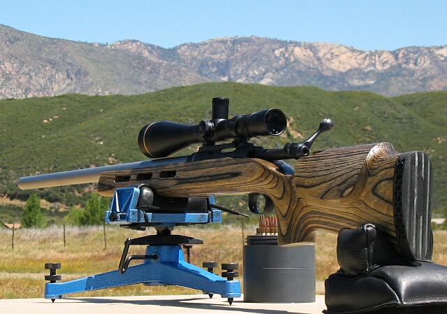

Well only took a few hrs to sand my Mastin stock to a reasonable finish then i used Birch-wood Casey Tru-Oil giving a rub with fine steel wool between coats have done a few stocks this way now and after 4 to 6 coats is fine and if you have a bump or scratch it is very easy to fix.
I take it they are a timber laminate and not synthetic
Bob,
I've seen a couple unfinished Mastins at Mac Tilton's shop, including one just like yours. I can confirm that the Mastins, as delivered, come much closer to "finish sanded" than most American-made Rutland laminates.
The Richards Microfit stock,not to be confused with Richard's Custom Rifles which are high quality) on my Savage looked like it had be cut out with a chisel. I must have spent 20 hours sanding the thing. I would not buy another Microfit stock. Not only was it "rough-cut" but the inletting was bad.
,BTW, that's an interesting label on the hanging bucket in the photo. :D )
