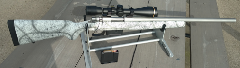

What twist rate? Here is a picture of my 6x45 Remington 700 with a 10 twist Pacnor barrel. I'm using 27.0 grains of IMR 8208XBR powder with 80 grain Sierra #1515 Biltz Varminters bullets and 80 grain Nosler Ballistic Tips bullets. Both shoot really well in the rifle.
