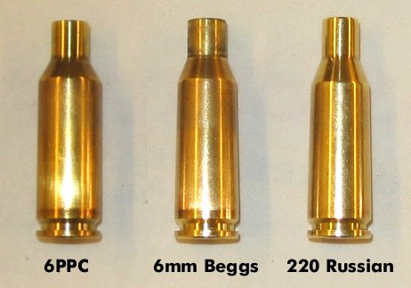

I was shooting in Texas with Gene Beggs, in his tunnel. We were shooting full-boogie short-range benchrest rifle with his 6mm Beggs cartridge (similar to 6 PPC). The more we shot the smaller the groups. But after 40-45 rounds or so I could tell Gene was getting antsy. He really, really wanted to clean that barrel, though our groups were getting smaller.
Anyway, I relented and told Gene he could clean the barrel after we took a lunch break. After we returned to the tunnel, I asked Gene to clean the barrel exactly as he would at a benchrest match. He used a bit of abrasive cream, and then two different solvents. Lots of brush strokes -- at least 15. Back and forth.
