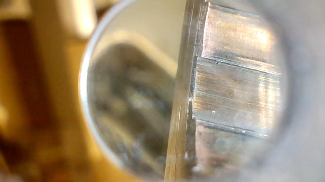

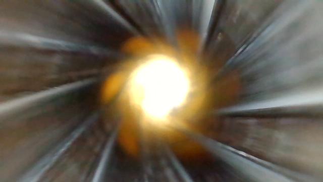

Background: This a custom barrel I just received. I borescoped it out of curiosity, and man, there's some things that worry me. For starters, the coppering seems excessive (yes they test fired it). Though that doesn't necessarily mean a barrel doesn't shoot well. Though based on the cost of the barrel, I was expecting something that was at least hand lapped but likely button rifled. The chamfering on the chamber end looks a bit rough. The crown is a bit suspect. It looks like perhaps the tooling was dull and folded the crown in.

Video showing chambering and some of the rifling
Video showing chamfering on breech
So that's not copper. Remnants from heat treat? It's an unfinished stainless barrel. Going to shoot it. With the naked eye, it doesn't look all that bad.
Leade looks pretty damn good/concentric to me, and no ragged edges.
Crown, certainly seen worse.
JMO, I don't see anything of concern to justify a call/complaint to the barrelmaker.
It looks like the barrel was crowned with a dull piloted reamer. If I got a barrel that coppered that bad, it would go back the same day. FY I button barrels can be lapped or not. I am surprised you didn’t ask. I would not expect it for that price.
Is it chrome lined? That's certainly an interesting color.
Chamber looks like chips weren't cleared often enough or the reamer was run too hard. But it does look like it was chambered straight. Crown could be better.

I have no clue what the gold/copper coloring is. I got a single patch with copper and then no more (patch out /wipeout). JB on a tight patch didn’t seem to touch the copper colored stuff. No clue what it is.
