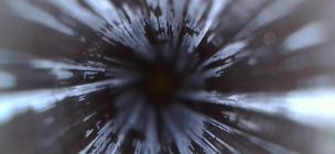

When I removed it there were shiny lead slivers on the patch. Borescope images attached.

I didn't take a photo of the patches. Didn't think it would be relevant at the time. It's a new barrel in this case. Less than 50 rounds.
Same area after lead removal. Yes, still a streak or 2 in this image.
