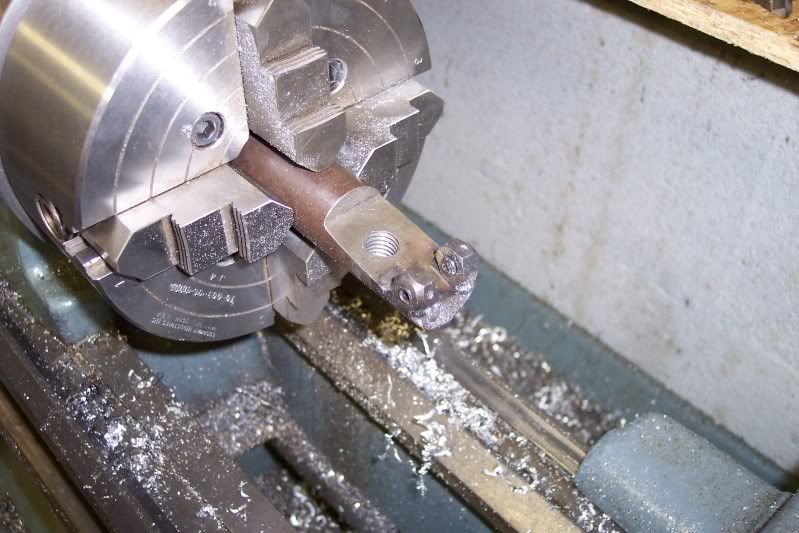

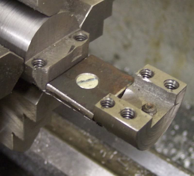

First one I tried was for Savage centerfire bolt handles.

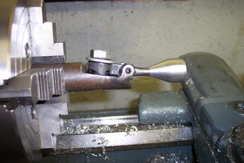

bare jig

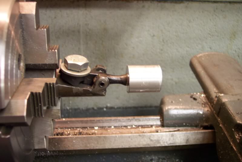

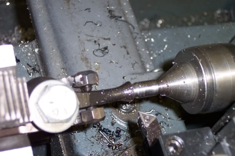

I turn off the old knob and thread the stub 3/8-24
1 1/2" aluminum blank

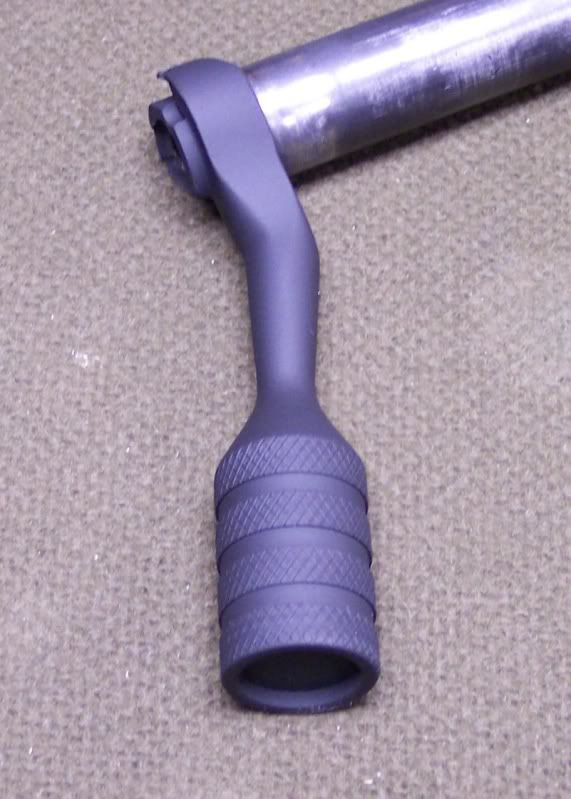

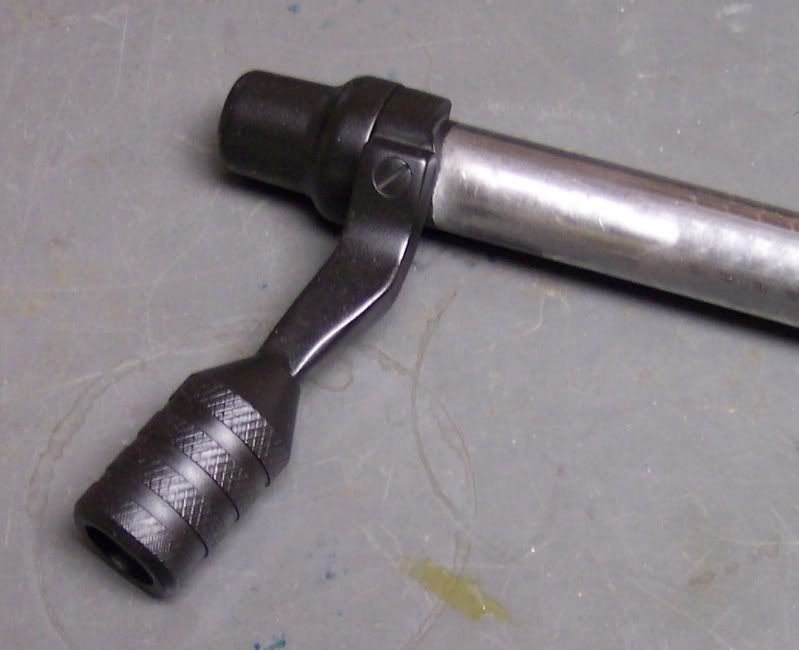

all finished
other designs

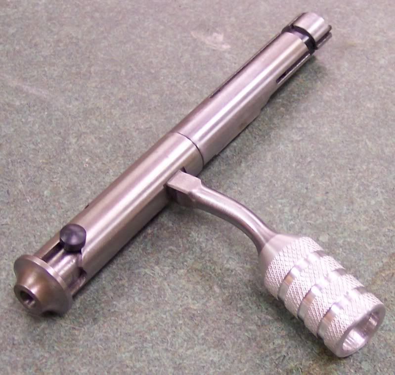

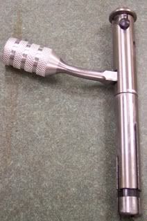

Here's my other jig that happened to work out for Rem. 700 short actions (my lathe isn't big enough to spin long action Rem bolts) and I modified it to work with Savage rimfires.
Rem 700 bolt
Savage MKII
Nice jig & keep having fun. Silver solder will eliminate machine screws, another hobby for you.

Thanks. The screw is just a preventative measure to make sure the handle stays put. I know of 3 of them that have come off in the last couple of years. Your bolt fluting looks very nice as well.
I added a 3/16" shim and the Rem 700 jig works for Win. Model 70 bolts as well.
removeable shim
finished bolt
Sweet, Mike. If I still have my long range 243 wssm (Win 70) when I get back to Ohio, I think I will have you make the #5 pictured one. But I think I would prefer it a tad shorter and skinnier.
