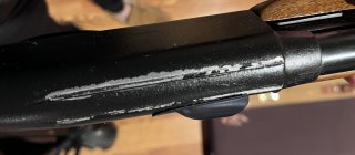

My dad blued and finished the .22 pictured. I tried to carefully get the scope mount off and it ended up peeling. I’ve cold blued before but I’m not sure what method he used to get an almost textured like finish. I guess it’s almost like a sealant that chipped off like paint. Any ideas?

I think I recognize that as the receiver on an old Remington semi-auto 22. Can't remember the model # but it's an aluminum receiver, and can not be blued. Might as well clean and strip, and finish with one of the products designed for aluminum, or -- leave it in the bright. jd
I would agree that it might be Alumahyde. The metal exposed appears to be aluminum, not steel. Standard blueing products or processes won't blue aluminum. Blueing doesn't add layers to material, as it appears you have in your pictures, but the various 'paint' products do.
It looks like duracote. It just delaminated due to poor surface prep or extreme oil saturation from under the scope mount or the mount was installed to soon after spraying

Yes, looks a lot like a Rem 552 or 572. I think that shield was only on the 552. Either way, the receiver of those guns is aluminum and can't be "blued". It does appear to be some sort of paint or spay on finish. I'd done them in duracote with great looks and it holds up very well. Overall, just way better than what I'm seeing in those pics. I'm with others, that can't be a "blued" finish. They were anodized from the factory.

Bead blast it off there, clean thoroghly and then clean it again. Then duracote or cerakote it with an airbrush. Prep is the key but both are good products done right.
Respectfully, that doesn't look like duracote unless it was done improperly. That stuff is actually a very good product but gets a bad rep because it's sold as a diy product when it should require a training to do right. It's not that difficult but prep is absolutely very critical, as is application.
