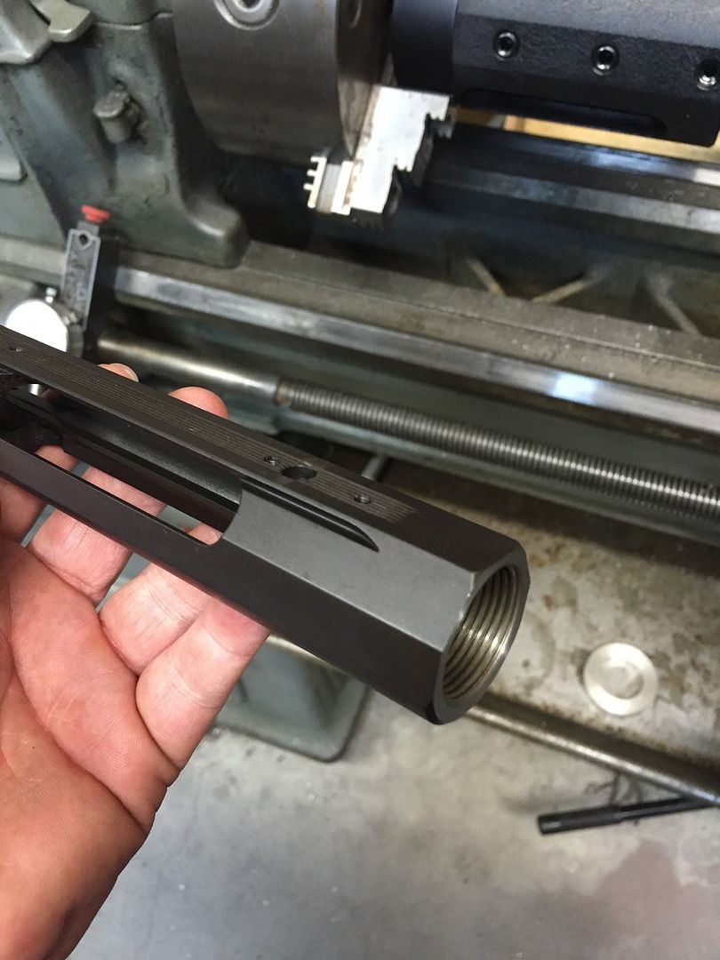

I do tikkas all the time (done a t3 just today) the trick on tikkas is facing off the front of the action to get rid of that goofy taper and put a real barrel shoulder on it. Threads are always straight and nice not done with a 30yr old rusted tap. Then i put a believable recoil lug on there. Lugs never need lapping and the boltface have always been true. Already got a good extractor. They turn out to be the nicest actions out there in my opinion. Best out of the box for sure.
These are also my findings. I made a jig to hold the action like a Remington, and I use a bushing and ground rod, like a Remington jig.
Adam
Heres what it looks like faced off to accept a believable barrel shank
