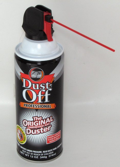

Buy some canned air and a long handled 1/2 inch paint brush and you will not need to tilt or turn your chargemaster upside down. Use the brush to clean off the sides and bottom of the storage hopper. And the canned air to blow out the feed tube and any remaining powder in the base. I also use the paint brush to tap on the hopper and shake any sticking powder loose.
I use the canned air also. I drilled a hole in my bench and built a little platform underneath to set the powder container on. On top is a funnel with a short piece of hose that extends into the powder container. I never more the scale.
