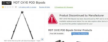

Seriously?? You maybe using the swivel kind that the rifle pivots on?? Mine are hard fixed to the gun and cant the gun a great deal on an uneven surface. Bought a new one that pivots and legs extend from gravity, will try it and let you all know how it works. Thanks for all the input!
