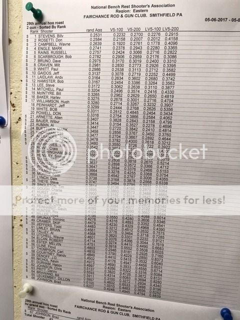

Can someone explain that match to a derelict prone shooter? What does V5 mean and LV5 mean? I am assuming each of those were fired at 100 and 200 yds? If so, his groups at 100 were great, but the 200 yd groups were outstanding.
What is the match format?
I assumed. Even in good conditions a 1/4 moa agg is fine shooting. Im amazed at how many guys have rifles that shoot 1/4 moa all day long ;)
Dos
v100 v200 are his heavy Varmit gun 13.5 lbs. The LV are his Light Varmit gun 10.5 pounds.
Each aggregate represent an average of of 5 targets with 5 record shots. So 10 targets at 100 yards then 10 targets at 200.
200 yard aggs are divided by MOA.
Actual measurements Billy shot 50 record shots at 100 that averaged .253 and then 50 record shots at 200 that measured .506
Hope that helps.

Thanks Bart. That is some great shooting.
