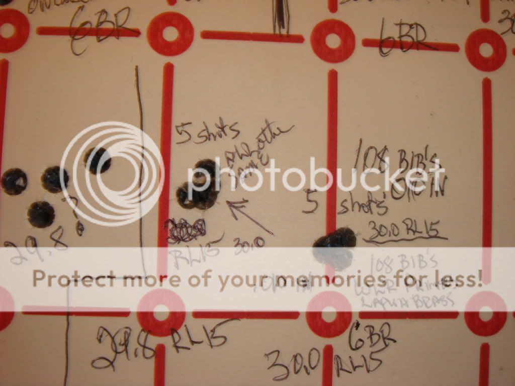

108 FB BIB's out of my 6br, excuse sloppy picture, 5 shot groups!
29.8 was all over the place, 30.0 did the trick in my rifle! 2nd round I took my time!
