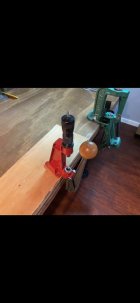

Lee single stage mounted on a short section of 2x 8 clamped to the bench with a Franklin Armory Universal seating die mostly. I also have a Sinclair with 260 Rem, 6BR and .30 Grendel dies but find the Lee/Franklin setup works better for me

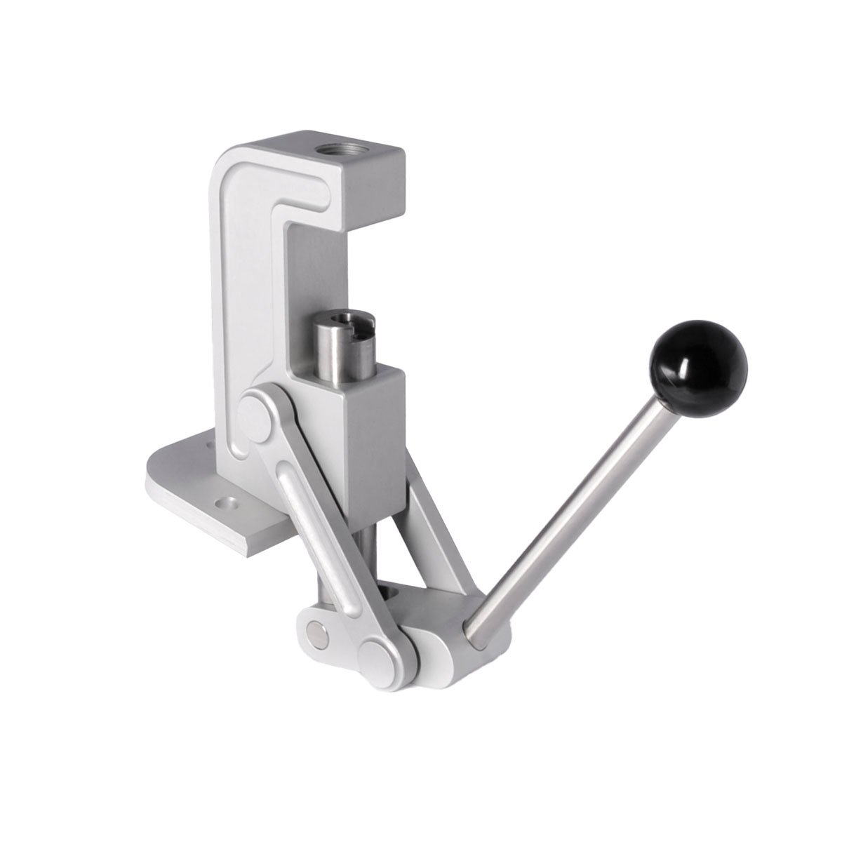

The advantage of seating with an arbor press is you can feel the amount of resistance as the bullet enters the case. There is an initial learning curve with this - especially in how you grasp the handle. I find "choking up" on the handle lessens the mechanical advantage and gives a better feel on the seating pressure. A press specifically made for reloading usually provides the best sensitivity. The K&M with the force measurement gives you the added benefit of the gauge reading the force which may be redundant once you become adept at "reading" the seating force by feel.

For cartridges that I don’t have a Wilson arbor press die, I use this cheap Lee press clamped to the bench. I’ve never detected any difference in accuracy when seating with this set up even if it is a little crude.

When you use something like the K&M I showed in the photo above, that whole blue toggle body is adjusted up and down as required.
