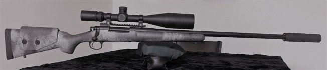

I probably use more RL26 in a variety of different cartridges than all others combined so I'm not much help to you on RL23 also my 6.5-284 is on a LA Rem 700 with a long throat and wears a 26in tube.
