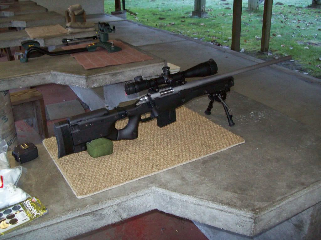

I just had a .260 put together and am really impressed with it's performance thus far - seems to not really 'hate' anything bullet-wise. Brass is a little bit of a challenge, but what isn't now-a-days as only Remington and Norma seem to be reliable vendors. Here's a pic of it,... ain't she pretty :)
It's an AICS,Accuracy International Chassis System). It's their 2.0 model - they sell a 1.0, a 1.5, and a 2.0 that has a folding stock. I've been able to stick the whole rifle into some pretty small bags for carry. :)
