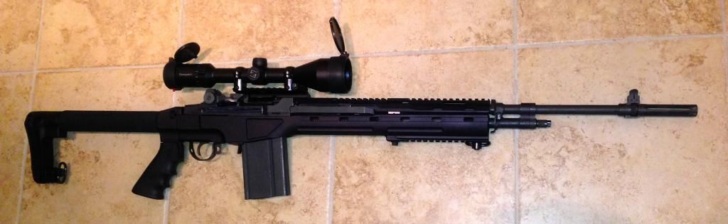

I'm getting a Leupold scope that will go on a tactical M1A. Which one should I get? I will be testing it from 100 to 600yds, maybe 1000. Price is no object. From a tactical shooter's perspective, what would you get.
I've got a modern day chassis system that was sent to me for T&E. I did a preliminary test with my Bassett scope mount and Zeiss Conquest and the results were great! I got eight consecutive 5-shot groups under 1.5" with 3 different batches/loads of ammo. I work 1 mile from Leupold and the are loaning me any scope I want for 60 days, so I'm not interested in other brands for that very important reason.
