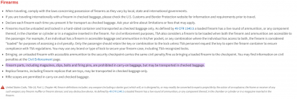

I put in my carry-on bag
Um, I wouldn't.
If you didn't get noticed, you are lucky since it would have been very expensive.
https://www.tsa.gov/travel/transpor...ines, clips,be transported in checked baggage.
If we each sneak one piece and then meet up somewhere past security to assemble..... then you can understand why even a magazine or piece part is a violation for carry on.
Into a separated piece of checked luggage is a different issue.
Weapon parts are not allowed for obvious reasons. Some folks jetting out of PHX after big matches and others leaving LV after a SHOT Show got to find out what it costs to tangle with the TSA to stay out of jail. You were lucky.
