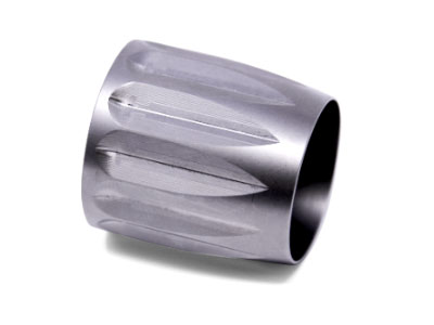

A little more money and larger and longer then most. I've been using these
from "International barrels".

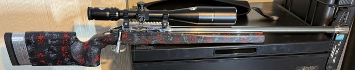

This is the newest one.
This nut uses a 1.25 inch wrench or a simple crescent wrench. The open end wrench is far superior to the ones that have to go on from the end of the barrel for convenience and ease of use.
