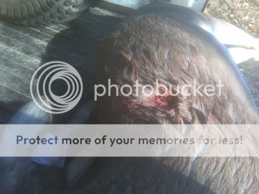

Here is a typical exit wound on a 120lbs Doe at 80 yards with a 6.5mm 140gr. VLD Hunting, impact velocity was around 2900fps, she dropped DRT on the spot and bled out completely in seconds. Amazing on deer. Shot one with my .300 win mag as well and a 168 VLD and results were comparable.
