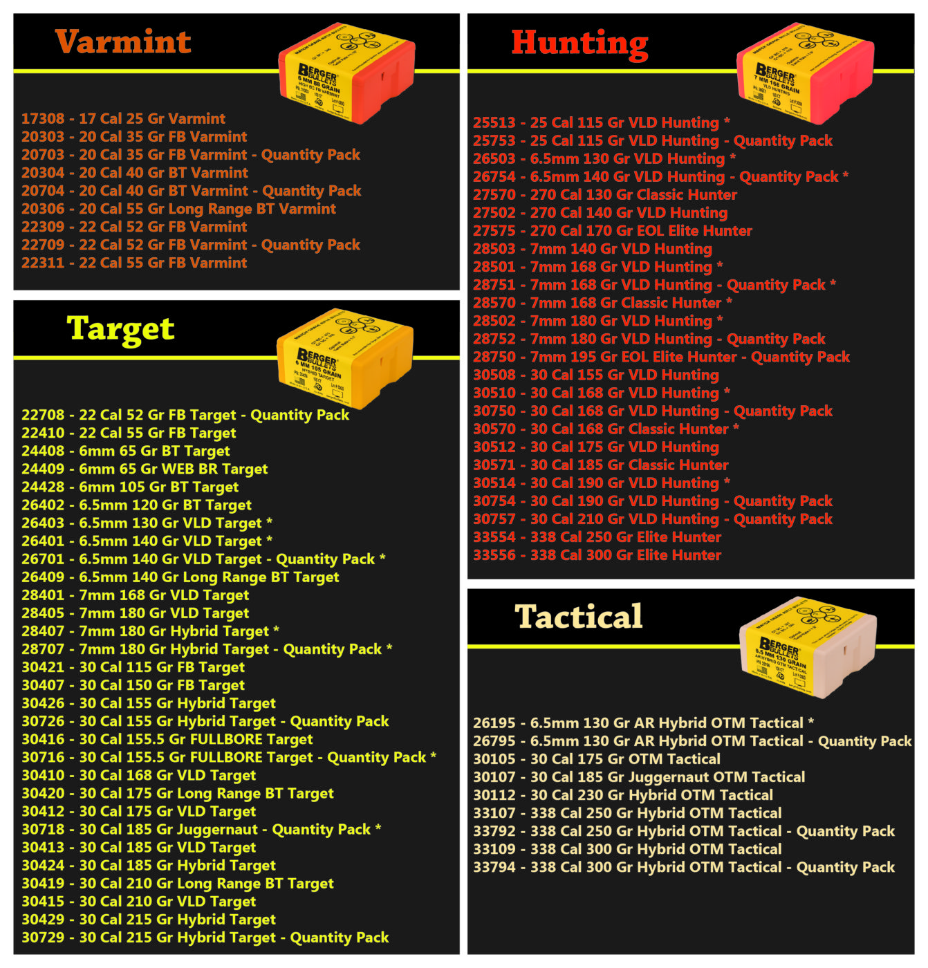

Please see the attachment for big news on Berger Bullet production upgrade and current inventory availability.
Berger Bullets In Stock Now!

Below is a list of the bullets we currently have in stock.
Contact us today to place your order, while supplies last.
Order Online: buybergerbullets.com
714-441-7200 or sales@bergerbullets.com.
*Top Seller

Thanks for the update Phil.
In the accompanying picture of bullet listings, I didn't see the 6mm 95 grain hunting listed. PLEASE tell me that it isn't being discontinued !
Dan Boone,
6mm 95 Hunting VLD or CLASSIC HUNTER are NOT being cancelled. Tentative production is end of June 2016
Stacy,
.224 90grain VLD target bullets- tentative production is end of June 2016.
