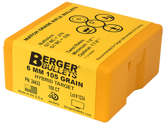

Berger also updated the 6BR/.243 105 Hybrid from 1:8 twist to 1:7 twist. They continue to review the performance of their bullets and this results in an occisonial update.
They are looking at what twist maximizes the BC of the bullet. Previously, I think they were just showing which twist would stabilize the bullet, and most likely give good groups. If you can shoot the bullet in a slower twist barrel with good group size, just be aware that the bullet may not be flying at the published BC. That really doesn't matter for F-class, since you have sighters, and the BC adjustment is not much. The optimal numbers as far as the twist rate calculation of stability have basically been updated, and are now more correct.

First, we made new advancements in the area of bullet stability and twist rates. Modern long range bullets have benefits that cannot be fully realized with a single digit twist rate number, such as 1:12”. There is a big gray area of marginal stability in which bullets can fly with good accuracy, but a depressed BC. Recognizing this reality, Berger is now listing a new optimal twist rate. The listed twist rate will stabilize the bullet to a 1.5 stability factor (or higher), which achieves its full performance (BC) potential.

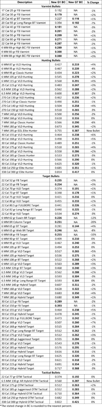

Typically the change in BC is within +/-2% from the original values, but there are a few that have changed by more than +/-5%.
These may seem like small changes, and they are by common standards. Berger Bullets has built a reputation for exceeding the common standards and providing the precision shooter with a higher level of information than what is commonly available.
For example, look at the 30 caliber 185 grain VLD Hunting bullet. The G7 BC of this bullet was updated from 0.281 to 0.286, a +2% change. If you’re using this bullet in hunting scenarios within a couple hundred yards, a 2% change in BC is meaningless to you. However, suppose you’re using this bullet for long range hunting, like many Berger customers. When predicting the drop for a long range shot, a 2% error in the bullet’s BC translates to a miscalculation in drop of 4” at 1000 yards. Considering that the vital area of your target may only be 8” to 10”, the 4” error in drop can be very important!

The table below shows a listing of the newly assessed BC’s, and the percentage change from the previous values*. The Berger website (including the product information page, the quick reference sheet, ballistic calculator and stability calculator) has been updated with this information. All new lots of bullets will be packaged in new labels containing this information as well.http://www.bergerbullets.com/wp-content/uploads/2015/10/smal-box.png
