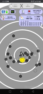

Truth right there. I use 8208xbr which is unfortunately also hard to find, but here's an example of what it will do with thrown charges (and iron sights).
I had strongly considered picking up some 4064, but managed to get my hands a bunch of n140 and sw precision so I'm set for a while.

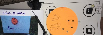

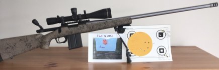

Well the rifle is completed here’s the pics from the smith of its accuracy out to 100m 500m 1000m. You can see the load they used was Varget. Time to start some development. So excited!!!!
