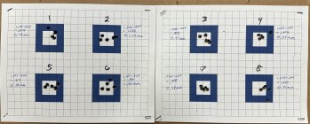

For the load development on this rifle, I ran through a ocw style methodology. The components used for load development are Hornady brass, Hornady 140 ELD-M, H4350, and CCI standard large rifle primers. I wet tumbled the brass, full length sized, annealed, trimmed to length, deburred and chamfered the case mouths and finally used an expander mandrel for final neck sizing. The first range session was eight charge weights from 40.3 to 42.4 grains of H4350 in 0.3 grain increments with five shot groups for each charge weight. These were shot in a round robin fashion with 2 minute cooling time between each shot and 5 minute cooling time between each shot string. Here are the target results.
Group# / charge weight / avg velocity / es / sd
#1 / 40.3 / 2631 / 51 / 20
#2 / 40.6 / 2661 / 32 / 14
#3 / 40.9 / 2676 / 43 / 17
#4 / 41.2 / 2687 / 16 / 7
#5 / 41.5 / 2690 / 22 / 9
#6 / 41.8 / 2713 / 27 / 11
#7 / 42.1 / 2725 / 22 / 10
#8 / 42.4 / 2746 / 22 / 10
After reviewing the velocity data, I decided to investigate the charge weight range from 41.1 to 41.8 in more detail, specifically 0.1 grain increments. These were shot in a round robin fashion with 2 minute cooling time between each shot and 5 minute cooling time between each shot string. The target results are below.

The first round data indicated that there was a node in the 41.2 to 41.5 range based on the velocity, group size and point of impact on the targets. The second round showed two nice groups in the 41.3 and 41.4 grain loads which also had low SD numbers. So, the final load I've selected is 41.3.
I realize there are other methods. This is the method I have used on multiple rifles and continues to guide me to what each rifle likes. Rosann did a great job shooting all of these groups in the round robin fashion. Overall, we're very pleased with the Bergara. Out of all 16 groups, only two were over 1 moa (barely). For a factory rifle, it's more than satisfactory.
42.1-42.4g range is where I would have concentrated.
Nice work up. I would’ve tested various seating depths and looked for a MV node in 42.1-42.4 neighborhood. I have exact same rifle. Berger 140 hybrids shoot just a little better than Hornady ELDM for me. Many competitors are shooting ~41.5 H4350, jump about15-20, Lapua brass, with Berger 140 hybrid at 2775-2800fps. I skip the round robin and results still reproduce very well.
Not withstanding pressure signs, I would have also explored additional testing in the low, mid and high 42.X powder range. Different rifle and barrel, same powder and bullet, Alpha brass, GMM205 primer with 42.1 for 2775 fps and single digit SD. Nice channel, keep having fun.

I'm fine with running it in the 41s. I'm concerned about running up into the 42s with Hornady brass. I'd rather have a stable and consistent load in the low 2700s and be able to adjust for a couple clicks more elevation at distance than ruin the brass too early. If we have to purchase factory Hornady ELD-M 140 ammo in the future instead of reloading, then this load isn't too far off.
