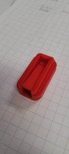

Here's my latest version. This is printed in PETG which has quite a bit of spring to it. I think I'm going to like this one better because it is adjustable. The follower is a seperate piece that can be easily swapped or modified.
I'll test tonight and report back.

yes, exactly. It's to be used in a single shot stock. If you had a stock with a magazine, you'd need something to hold it in place. Something like this:20260209_093758.jpg
Not sure if they'd have anything for that Bergara, but I bought a single shot tray for my old Savage I have turned into a bench gun. It wouldn't feed 6BR cases at all , but for $11.00 EABCO.COM sent me a tray to fit over the mag follower.
