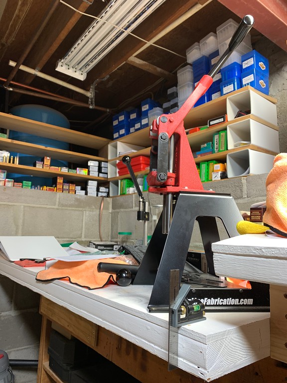

2.5" thick chunk of bowling alley slab set in a 2x6 frame supported on 4x6s, finished dimensions 87 x 34 x 40. Solid as a rock. Rear shelf/cabinets not finalized yet, but fully functional as it sits. Variation of NRMA bench.
