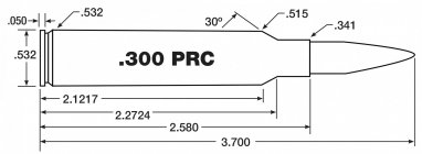

It's a cool looking case, almost looks like a longer PRC, with shoulder difference. It might be knocking on 300WM performance.
The 30 Newton has exactly the same capacity as the 308 Norma and shoots the same loads to the same velocity. In fact, the cartridges are so dimensionally similar that I can't help but think the people at Norma must have looked at the Newton offerings when they designed the 308 and 358 This is especially so in the case of the 358 Norma. My favorite load is 70 of 4350 behind a 180. Velocity is about 3050 with no drama. I have always maintained that the cartridge selection would be a lot different if Winchester had opted to chamber the Model 54 or Model 70 for the 30 Newton rather than the 300H&H. The Newton was a much better fit for the action and would not have required that the mag well be opened up and the action weakened as for the H&H.
