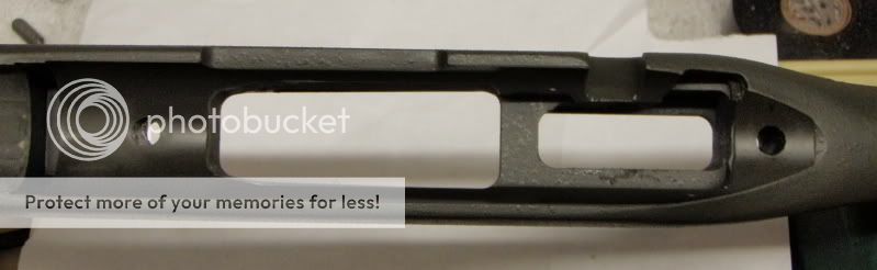

Last year I took my savage 7mag to a gunsmith to have glass bedded. It was shooting about 3/4 inch groups before the bedding and 3/4 after bedding. I am now finding that the gun barrel is not free floated also. Before I took the gun back out to the range, I wanted to see what was going on and what kind of job the gunsmith did. I don't see very much that was done, It looks like most of the bedding compound was put down the for arm under the barrel. There is very little bedding compound around the front lug, and none around the back lug, the chamber, or the tang. What do you guys think, the guy charged me 150 bucks to do the job and kept my gun for 7 months.
I see what you mean Those shiny spots where the action sit tells it all. he didn't bed the action. Is that bedding in the barrel channel?

That is sure a sorry bedding job, the rear was not even touched, and the front don't seem to have much either, and no reason for doing the barrel channel... You really need to try and get your money, or at least most of it back from Bubba..... and then start all over again..

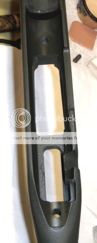

Not a Savage but what a bedding job should look like with the barrel floated.
I dyed the bedding to match the OD stock as good as I could.
Only difference on a Savage is 98% or better leave the tang floated also.

Eddie- nice job.....once I learned to lay in enough epoxy so some excess oozes out, my results are looking like your fine job.

Nice bed job eddief, looks real good.
That is to bedding as the Frankenstein monster is to plastic surgery. Get your money back and don't let the man touch your rifle again.
That is awful, like others said, get your money back. The guy doesn't have a clue. Hog all that epoxy out of there, relieve the wood and do yourself a nice Devcon job. This is an awesome tutorial by Richard Franklin http://www.6mmbr.com/pillarbedding.html. I started doing my own per these instructions and things have all worked out well for me.
