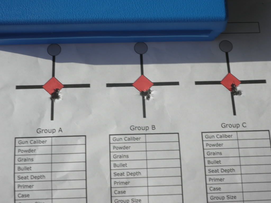

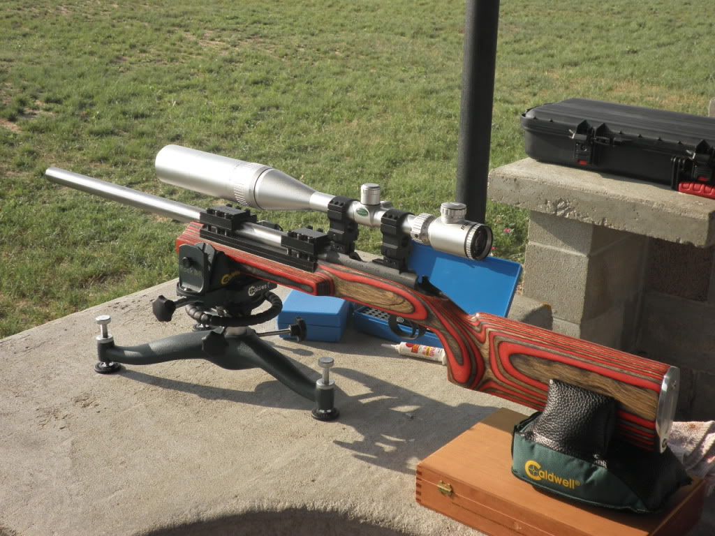

Here is my barrel blocked .22LR BR rifle. I only shoot club level and for fun and did not want to mess with a tuner, so went with a heavy, ridged barrel and I could not see hanging a 26" 1.045 diameter tube of stainless steel of that tiny CZ action :D went with the block and free floated everything. It is a shooter! 5 shot groups at 50 yards in a gusty 10 to 15 mph wind, all shot as fast as I could load and shoot once wind settled down. Smallest is .158 largest ( wind got me on one shot) was .249
Have to agree though, for pure comp rifle a tuner and free float reverse taper is the way to go.
Slick looking rifle and block! What barrel, and chamber did you use? What about headspace? What scope, and how do you like it?
