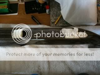

Here is what I ended up doing.

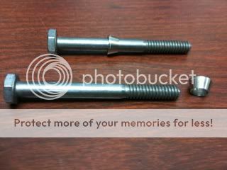

I welded up some studs to locate the action. One side is 1/4"x28 and one side is 1/4"x20. I found some 1/4" compression cones to center up the studs into the pillars, and used wing nuts to tighten them down.
I opened up the inlet and opened up the radius on the pillars to allow the action to sit without stress when the wingnuts are tightened down.

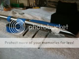

I then taped it up and dammed off areas that I didn't want glass with model clay. (I used a little too much because some squished into the recoil lug area)

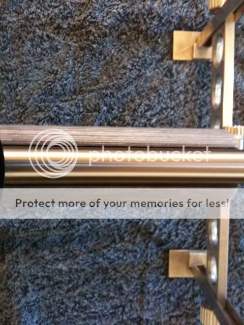

This is how it came out. I think it is ok. The clay that squished into the recoil lug area just blocked off the forward part, but the rear of the recoil lug as well as 90% of the bed of the action is fully skim coated. The center of the pillars contact the action, and the barrel sits straight in the channel.
