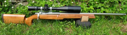

I now own the 6mmSLR and will never regret this decision. This is the 'drop dead' 243 long ranger (IMHO). I love shooting this gun. I have shot several different bullets from the 87gr VMAX up to the 108gr BERGER BT. This thing is deadly accurate. You will love the long case neck for providing a variety of bullets you can use and different seating options.

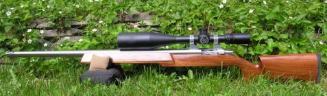

Looks very similar to John Adams .243 BR-K
I'm very happy with it
