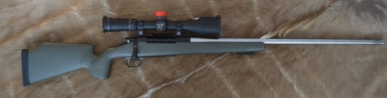

I got it mostly done today, 7lb 5 oz is pretty light with a #5 contour
300 PRC
Bat Vampire aluminum/steel action
McMillan game hunter, carbon fiber shell, enhanced edge fill
#5 Lilja 9tw 3 groove 24" with Harrell's brake
Jewell trigger
CFE 9 Wyatts box
Hawkins floor plate
7lb 5oz without optics

You have a type :) came out nice

Good hell I’m just going to have to call and order me one of these Vampires. It’s been killing me ever since Alex posted this. Now what to build out of it?
I’d be surprised if the machined the insert first instead of inserting and then machining. A cryo bath for the insert and a mild press, then allow it to come to temp and machine it. That’s how I’d do it.
I have been specifying cryo'd cromoly on every action I order for a couple years now. Theres a couple reasons for that. The insert is cryo'd cm thats a few points harder as well. Its very precise. The way the barrel torques up is different. Its just tight, hardly any rotation after hand tight.

Curious why you went with a Lilja barrel?
The couple Lilja barrels I owned and others friends and family have owned were very finicky and tough to find accurate loads. Eventually all shot well, but took a ton of work. Lilja has been at the bottom of my list for a long time now just because other barrels seem to find multiple accurate loads very quickly and tune better.
