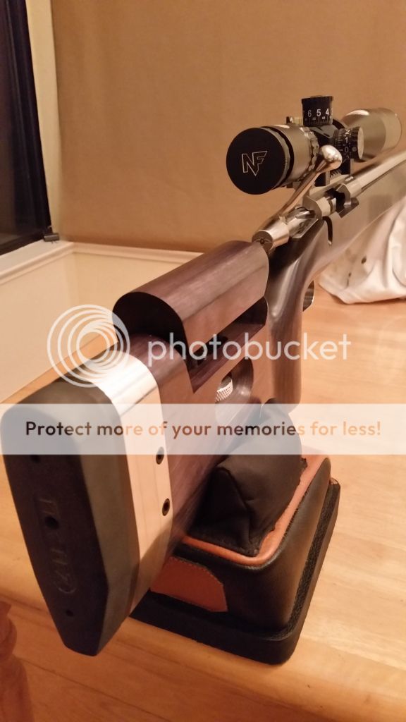

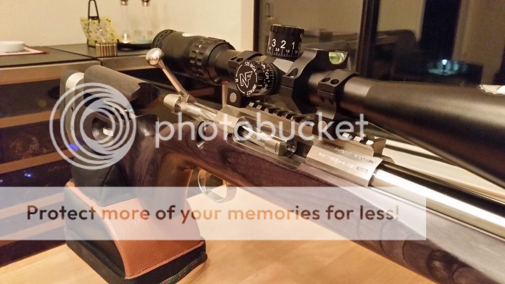

Gun is right around 20 pounds as is. 30" Bartlein 5R barrel 1.25" taper to 1.00", Jewell BR trigger, BAT Model M action with 338 LP ejection port (RBRE), BAT Trigger Guard, PR&T Lowboy in Black Laminate cut down 2" from the tip with a satin finish, NF 2015 Competition 15-55x with NF Ultralite Rings.
Now, for some gun porn...

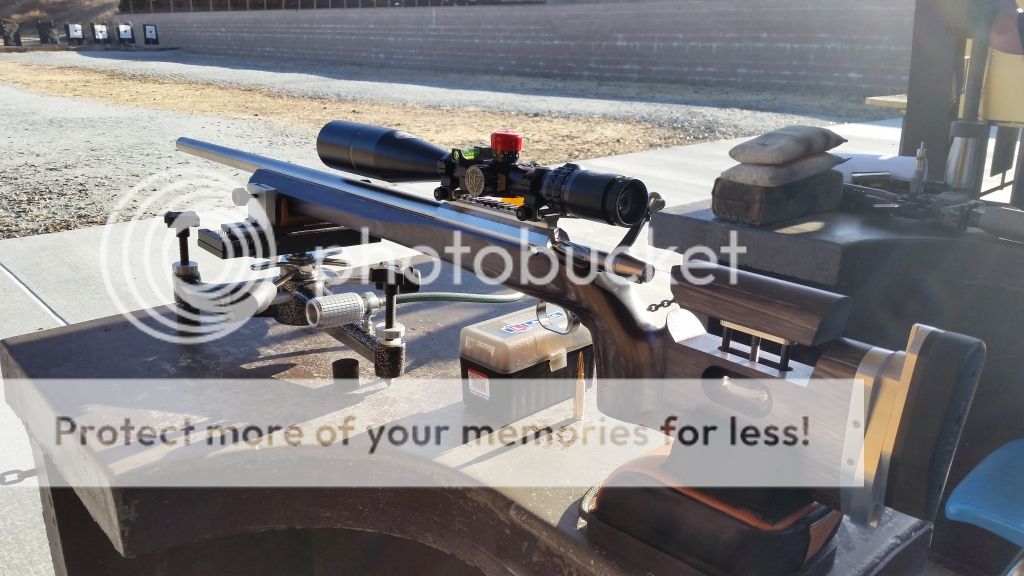

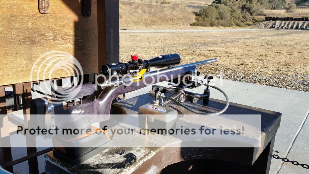

Took the rifle out to the 100 yard line and got the scope sighted in less than 5 rounds. No cleaning done at all during this range session. IMO, a barrel cleaning break in process is a little overrated and this range session shows that! Prior to going to the range, I did do a good cleaning of the barrel with patches and a nylon brush to get any gunk out.
Here is my load:
Bullet is 180gr Berger Hybrid tipped with Whidden Pointing Die
Brass is 6.5x284 Lapua - expanded with 7mm mandrel, then resized with Whidden 284 Shehane bushing dies
Powder is H4831SC - 54gr
Loaded 10 thou from the lands.

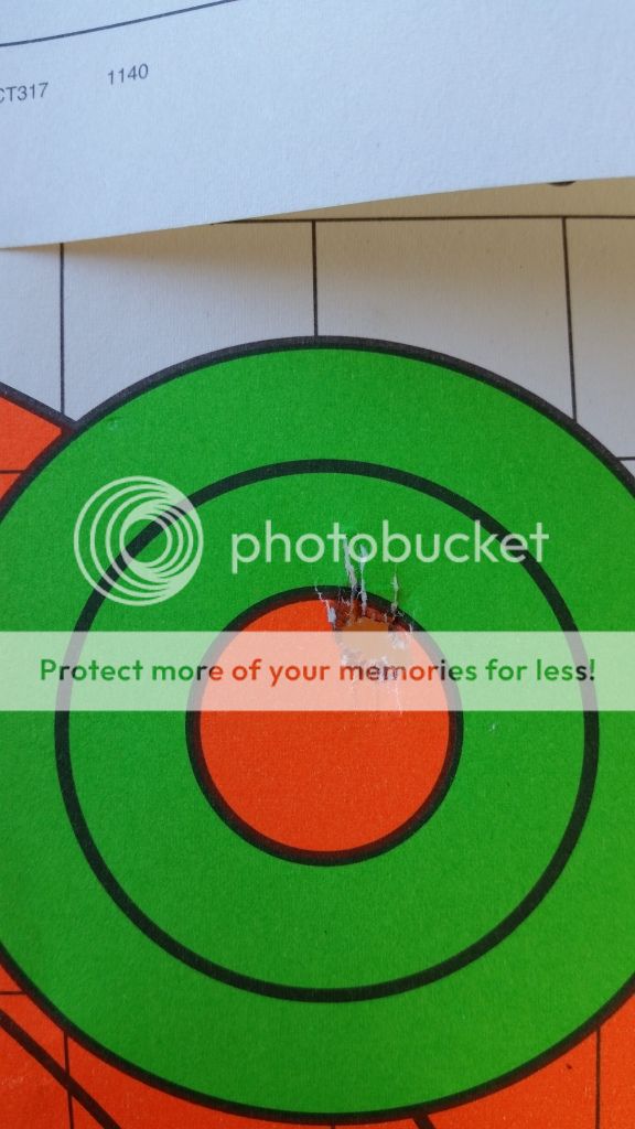

Gun started to shoot sub 1/2" groups right off the bat and then proceeded to shoot better and better. By round 10-12, groups started to tighten up to the teens and this was with fireform loads! 54gr H4831SC was enough to blow out the cases to the desired case dimension for the Shehane. Stopped at round 20 as it started to shoot sub- 1/4" groups consistently. Going to stretch its legs out to 300 yards for some load development and ladder testing.
One thing I do want to note is that with the BAT action, there seems to be binding if I slowly eject the spent brass. A more deliberate ejection was needed for it to eject nicely. Not an issue, but I just didn't want my brass flinging 3 feet to the floor.

stretched its legs out and found out that for my fireforming, 55gr of H4831SC to be the right ticket, so I settled on this for my fireforming. shots were 3/8" or better for 5-shot groups. velocity was about 2795fps. ES was about 29 fps...not sure what ES i should be expecting with fireformed loads.
