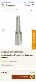

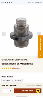

What's everyone's recommendation for a real basic bare bones expanding Mandrel set up ? Really just need some to expand the necks on home made brass so I can neck turn. Really only using it for one little odd ball caliber so would prefer not to spend an arm and a leg lol

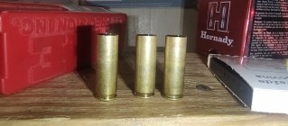

Not trying to be a know it all but why did you cut that far down the shoulder? I bet those little suckers would be real hard to anneal too.

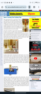

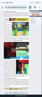

Just trying to follow what I was reading honestly.seems some just kiss the should some do into the shoulder... Idk all I know is apparently you supposed to run these up till the cutter matches the shoulder so... And this is an article from accurate and well...

As far as annealing it's not hard at all lol. Just a little tedious.
