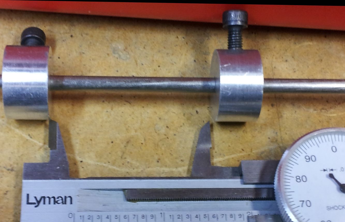

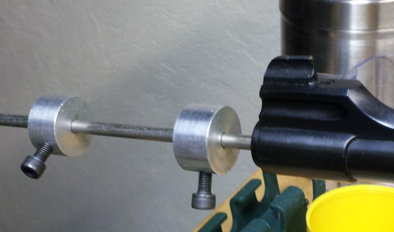

I do it differently. I use a tool that goes in the muzzle and measures the distance from a closed bolt - then it measures the distance to the nose of a bullet that is against the leade (rifling)... the difference is my OAL to "kiss" the rifling, and I use the seating micrometers to adjust from there.
I've done it that way too but I basically stopped dealing with COL because there seems to be too much variation due to inconsistencies in the bullet nose. I just deal with CBTO now. I use the RCBS Precision Mic...it gives me very consistent results which seem to be confirmed by marks on the bullet when I move my Micro Seater die to a jam. That little bullet tool they provide can be a pain though....my Savage extractor doesn't seem to want to grab it unless I have the set screw in it tightened juuuuust right.
