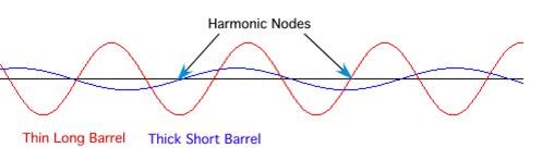

Since I first heard about barrel harmonics, I've been going OCD to try and understand what's going on with it and to say the least, it's actually very complex the way impulses travel back and forth at the speed of sound in steel. To understand on the simple side of it, the pic below should give you some idea about why you see those variations as it having to do with where the muzzle is pointing at a particular time with the vibration:
PS: The "whip" of the barrel that we can often see, especially in slow motion, occurs well after the bullet has cleared the muzzle. It's the other higher frequency harmonic modes at work that's producing such variances.

Is the node at the center of travel where the barrel wave is moving the fastest or at the crest or trough of the wave where it slows and reverses direction? Seems to me it would be the most consitent for a longer time at the crest and troughs as it slows down.
Is the node at the center of travel where the barrel wave is moving the fastest or at the crest or trough of the wave where it slows and reverses direction? Seems to me it ould be the most consitent for a longer time at the crest and troughs as it slows down.
If you put that sine wave picture in motion, the top and bottom peaks (the anti-nodes) move up and down, or back and forth, to put it simply, from peak to peak, but there's no movement at "the center of travel". . . the node of the sine wave.

If you put that sine wave picture in motion, the top and bottom peaks (the anti-nodes) move up and down, or back and forth, if you will, from peak to peak, but there's no movement at "the center of travel". . . the node of the sine wave.
Hmmm - Not sure I agree. There is maximim movement at the mid line of the sine wave.
In that video looking only at the vertical velocity of the dot on the sine wave, it is moving the fastest at the center line and slowest at the peaks and troughs.
Edit to add - if you could go to the right side of your computer monitor and look at the sine wave coming at you the path would look up and down with speeding up in the middle and slowing down when it changes direction.
Wave motion and circular motion are related. If you look at circular motion from the side instead of the top, think of a pingpong ball going around on a record player, the pingpong ball would look as if it is moving from one side to the other slowing down and turning around then accelerating to the other and slowing down and turning around.
Maybe we are saying the same thing but 90 degree out of phase?
That's a whole different sine wave motion than what you get with standing wave with vibration/harmonics.
Granted, yes, it's very much oversimplified but I'm not sure what you're specifically addressing. So, I can't agree or disagree. Not many will ever watch it live on an o-scope but we can all see what matters, on target. On target, it appears over simplified too. It does appear on target as a relatively smooth sine wave. In the real world, it's anything but a simple, smooth waveform. There are muliple frequencies going on at once and the longitudinal aspect...and radially, all happening at the speed of sound in steel, which is far greater than the sine wave or frequency near the muzzle will represent...depending on equipment used to measure, to a large degree, I'm sure.
Granted, yes, it's very much oversimplified but I'm not sure what you're specifically addressing. So, I can't agree or disagree. Not many will ever watch it live on an o-scope but we can all see what matters, on target. On target, it appears over simplified too. It does appear on target as a relatively smooth sine wave. In the real world, it's anything but a simple, smooth waveform. There are muliple frequencies going on at once and the longitudinal aspect, all happening at the speed of sound in steel, which is far greater than the sine wave or frequency near the muzzle will represent...depending on equipment used to measure, to a large degree, I'm sure.
Yes, over simplified as the vibration is quite complex as 1raggedhole's link to an illustration shows. The complex resonance gets to the muzzle long before the bullet, because of the speed through steel. The bullet traveling down the bore is changing what happening at the muzzle all along the way until it exits. Regardless of the complexity of the resonance, the barrel is still subject to the resonance vibrations that's natural to the barrel, which moves as a standing wave.
I agree. The way I look at it is this and it's based on doing vibration analysis and seeing what happens on target....seeing bullet exit relative to muzzle position. A tuner being at the end of the bbl is adjusting for the "average" of what's going on behind it, consistently. Yes, that's probably an oversimplification too but it works on target, agrees with vibration analysis and it explains why such small movements of a tuner can affect phase time without significantly altering frequency. There is still a lower "natural frequency" that overplays the multiple higher freqs at work due to forced deformation. It can be seen with something as simple as a guitar tuner while exciting the bbl.
