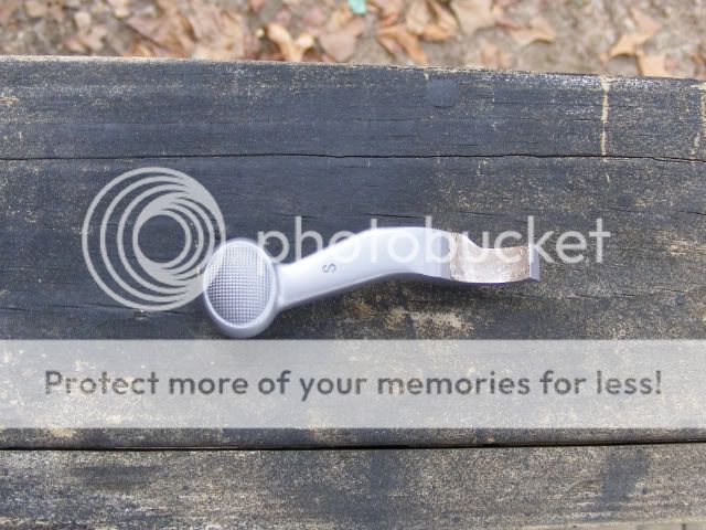

You are correct. #99 just has a burr. A Savage 99 doesn't have a controlled round feed. I* do put a PT&G 3 pos safeties on my Remington and clones because they look cool. Never had a factory one fail me. Even though I have never had a Remington bolt handle come off I have Dan Armstrong weld a custom on because the factory handle is ugly.
