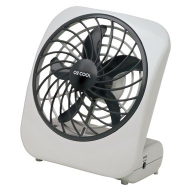

Was talking with a couple other shooters during a cease fire the other day about using a fan instead of a mirage band.
Something like this
Usually there is a slight side wind at our range that seems to blow the rising heat off the barrel and it only becomes a problem when the air goes totally still. Temps range in the 50's to high 70's for the most part.
Just wondering if this type of fan is used by others and if it would be of any help. It seems to me that just moving the air across the top of the barrel would be a benefit.
What say you all?
FWIW, the fan is battery powered and costs $10. Supposed to be quiet and moves a lot of air for it's size. According to the reviews it's enough to cool off "menopausal women" even in Florida heat 8) 8)
I know one shooter that uses one of those. He seems to like it.
I'm not sure if it would stand up to the rules about electronic devices ahead of the ready line. I think it is electric, not electronic, so I think it is legal. Only an NRA referee can make the final call on it and only if it gets challenged.
I've thought of the same thing myself, Even with a mirage band, sometimes it gets so still that the mirage sneaks out at the muzzle and plays havoc with my sight picture.
The scopes don't contain a circuit board of any type Roger, therefore, would not be considered electronic.
Honestly, its a fan with a power pack. The scopes with lights and switches are considered electronic to me so whats the difference. Maybe they should incorporate laws for the laws. It almost sounds like a serious question to pose to the association. The nra or whomever needs to relook at the laws and change them.
I'm a sling shooter and I use the very same fan shooting prone keep just enough air moving to keep the glasses unfogged. It works for that in this swamp I live in. Would I drag it to the line at a national level match? Heck no! I can see that going over about as well as an umbrella with an official.

In response to your question, I thought the same about using a fan instead of a mirage shield and tried it last weekend on a 30BR. After 32 rounds without the shield and with a 16 inch fan on low speed, no mirage was apparent as it would have been with the shield.

Fans don't contain any devices that would be considered electronic by any standard I've ever heard of. Electric yes, electronic no. Nothing but an old fashioned motor, battery, and switch, not even a solid state switch.
Based on the feedback I think I'll give it a shot. For some reason I've never been a fan of mirage bands. Maybe because I've never found a way to both remember to bring one to the range and a good way to attach one.
amlevin Velcro works to hold mirage shields to the barrel. And there are all different kinds of materials that can be used. No rules on that yet!

The battery powered fans work great at keeping the barrel mirage out of the scopes view. I have used one in competition and will again until I am told I can't then I will have no problem not using it. I don't think there is a problem with them, they don't tell you anything about when to shoot or what the conditions are they just blow air.
Most mirage shields are way too skinny to work effectively.... use more material in the width and you can forget about the silly fans. You can get fancy, but a strip of target attached with tabs of masking tape is hard to improve upon. K.I.S.S.
