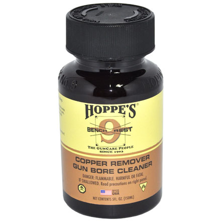

Since you specified Hoppe's there's this...
There may be better solutions.
